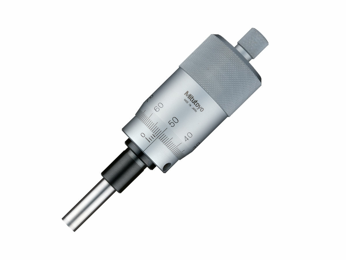

The Mitutoyo quick feeding spindle micrometer head feeds at 1mm per revolution for faster adjustments without sacrificing accuracy.

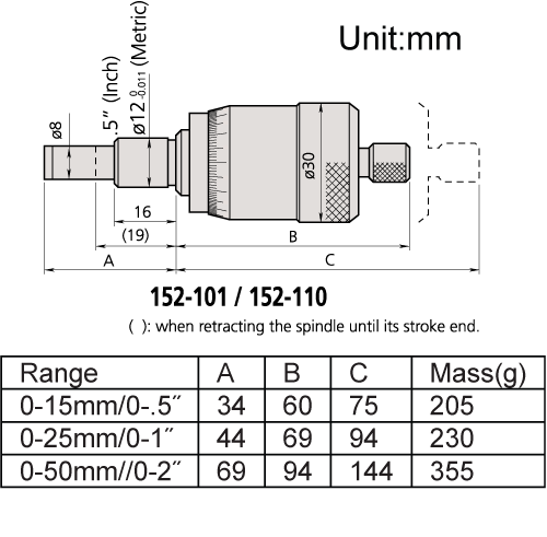

The Mitutoyo quick feeding micrometer head is available in three different lengths and spindle ranges, providing faster adjustments and measurements on many different applications. The flat measuring face is constructed of carbide and is lapped for lasting precision.
  • Spindle feeds at 1mm/rev
  • Mic head has a 30mm thimble diameter
  • Spindle ranges available are 15mm, 25mm and 50mm
  • Spindle diameter is 8mm
  • Mic head total lengths (at stroke end) are 109mm, 138mm, and 213mm
  • Mounting stem diameter is 12mm
  • Flat spindle faces have lapped surfaces and are constructed of carbide for more accurate measurements over time
  • Thimble is hard-chrome plated with laser-etched scales for easy-to-read measurements
SERIES 152 Technical Data
Technology: Mechanical
Units: Metric
Graduation: 0.01mm
Measuring Faces: Flat (carbide tip)
Stem Diameter: 12mm
Stem: Plain
Spindle pitch: 1mm
Scale Surface: Hard chrome plating
Order No.: Product Image: Range: Accuracy: Mass:
152-102 0-25mm ±2µm 230g
152-103 0-50mm ±4µm 355g
