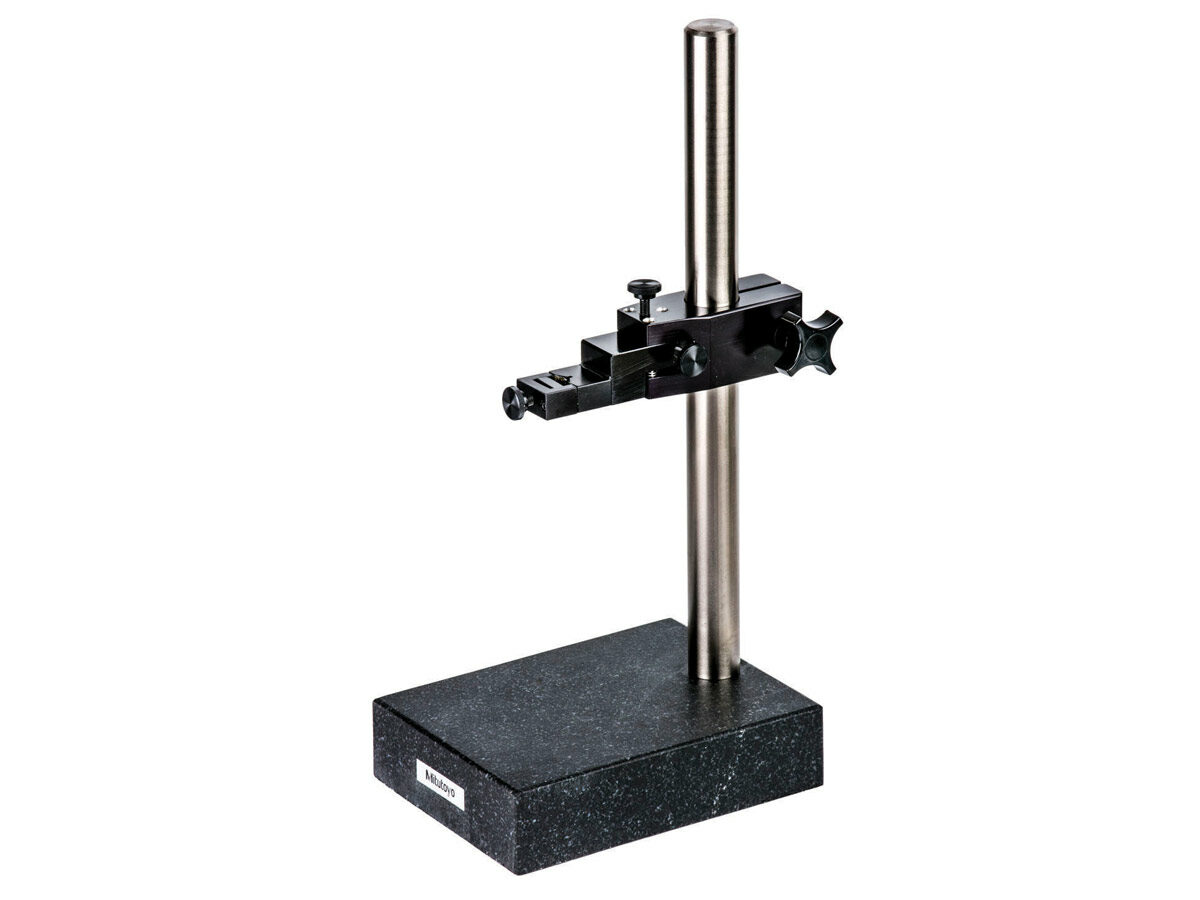

The Mitutoyo precision granite comparator stand with black granite base is specially constructed to give precision measuring instruments greater stability for exact measurement accuracy.
The Mitutoyo precision granite comparator stand is the basic building block for special-purpose, precision measuring equipment assembly. These precision granite stands hold Digimatic indicators, Mu-Checker cartridge heads and linear gages for many different types of measurements and measuring applications. The rigid granite base provides a heavy, stable and exceptionally flat foundation for accurate, repeatable comparison measurements. The threaded column and adjustment knob gears are precision ground for smoother course movement and better fine adjustments.
- Granite base is free from burs and pileups
- Stand maintenance is easier due to the non-rusting granite base
- Precision milling of the base ensure flatness is always accurate
