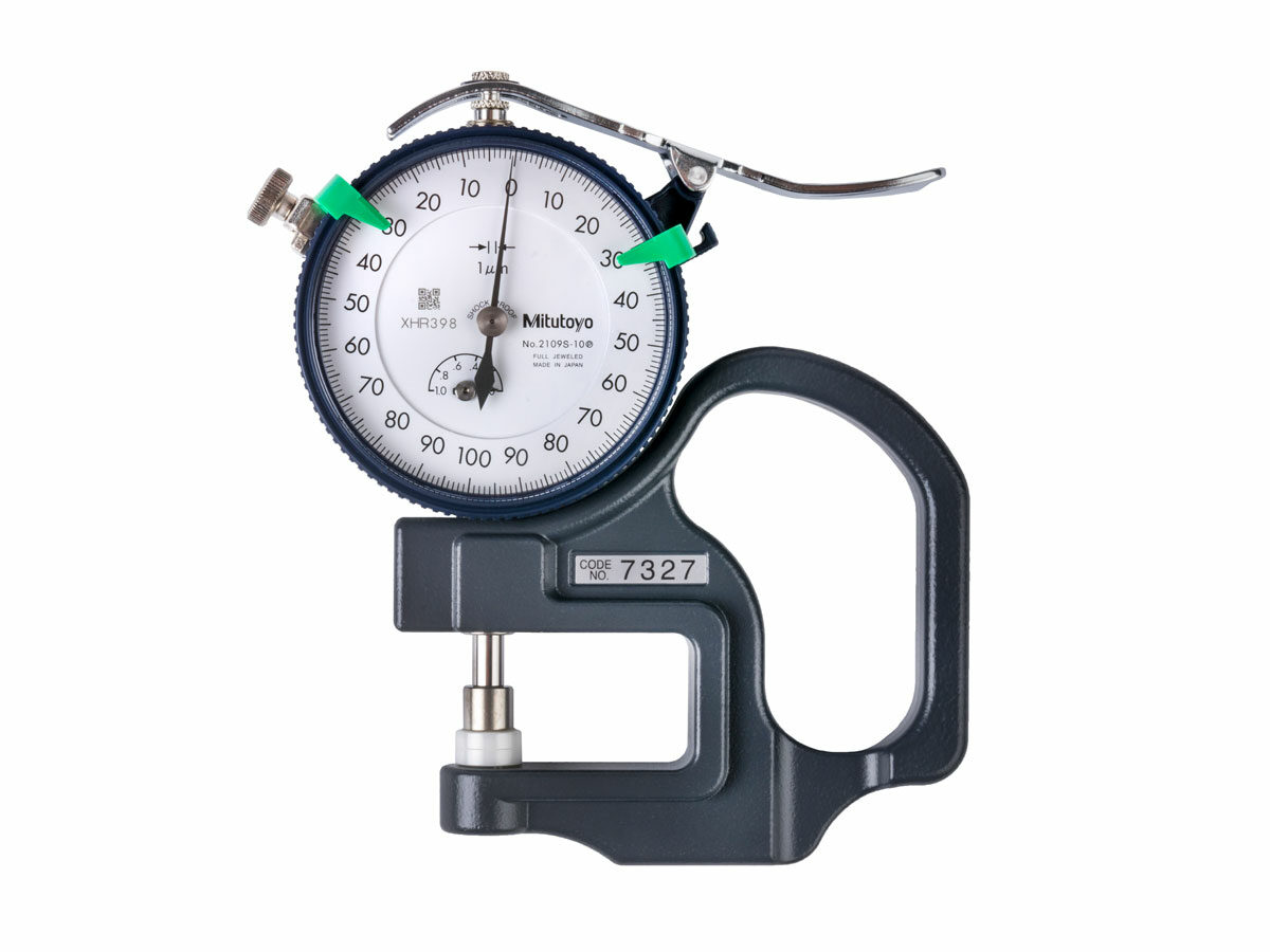

The Mitutoyo flat anvil thickness gage quickly measures the thickness of different materials or objects with high accuracy. These gages are available with standard or deep-throated frames along with fine dial readings.
Flat Anvil Thickness Gages
The Mitutoyo flat anvil thickness gage measures the thickness of a wide range of materials and objects including film, wire, sheet metal and other similar materials. Our fine dial reading gages (7326S or 7327) are ideal for measuring the thickness of paper. The indicators’ contact points are coated with ceramic for durability and corrosion resistance. The grip handle, easy-to-reach lifting lever and spring-loaded spindle allows for quick and easy measurements without sacrificing accuracy and the white dial face is easy to read.
- Metric and Inch models available
- Available with fine measurement dials
- Available with deep-throated frames
- White dial face for easier, precise measurement readings
- Anvil and contact point are constructed of ceramic for better corrosion resistance
- Measuring force is 1.4N or less
| Technology: | Mechanical |
| Spindle material: | Ceramic |
| Anvil material: | Ceramic |
| Order No.: | Product Image: | Units: | Range: | Graduation: | Accuracy: | Measuring Force: | Remarks: |
| 7300A | - | Inch | 0-0.5" | 0.001" | ±0.001" | 1.4 or lessN | Standard |
| 7301A | - | Metric | 0-10mm | 0.01mm | ±15µm | 1.4 or lessN | Standard |
| 7304A | - | Inch | 0-1" | 0.001" | ±0.002" | 2.0 or lessN | Standard |
| 7305A | - | Metric | 0-20mm | 0.01mm | ±20µm | 2.0 or lessN | Standard |
| 7321A | - | Metric | 0-10mm | 0.01mm | ±15µm | 1.4 or lessN | Deep throat |
| 7322A | - | Inch | 0-1" | 0.001" | ±0.002" | 2.0 or lessN | Deep throat |
| 7323A | - | Metric | 0-20mm | 0.01mm | ±22µm | 2.0 or lessN | Deep throat |
| 7326A | - | Inch | 0-0.05" | 0.0001" | ±0.0002" | 1.4 or lessN | Fine dial reading |
| 7327A | - | Metric | 0-1mm | 0.001mm | ±5µm | 1.4 or lessN | Fine dial reading |
