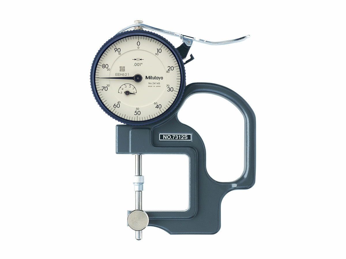

Mitutoyo lens thickness measurement dial indicators quickly measure the thicknesses of a wide range of lenses up to 10mm/.5” with high accuracy.
Series 7
Lens Thickness/Reverse Anvil Gages
The Mitutoyo lens thickness measurement dial indicator uses a reversible anvil to measure the thickness of various lenses with high accuracy. The indicators’ contact points are coated in ceramic for durability and corrosion resistance. The grip handle, easy-to-reach lifting lever and spring-loaded spindle allows for faster, easier measurements without sacrificing accuracy. ty, and the white dial face is easier to read.
- Easy to reach lifting anvil for effortless measurements
- White dial face for easier, precise measurement readings
- Anvil and contact point are made of ceramic for better corrosion resistance
- Measuring force is 1.4N or less
SERIES 7 Technical Data
| Technology: | Mechanical |
| Measuring Force: | 1.4 or lessN |
| Reverse anvil: | Yes |
| Required Accessories: | - |
| Order No.: | Product Image: | Units: | Range: | Graduation: | Accuracy: |
| 7312A | - | Inch | 0-0.5" | 0.001" | ±0.001" |
| 7313A | - | Metric | 0-10mm | 0.01mm | ±15µm |
