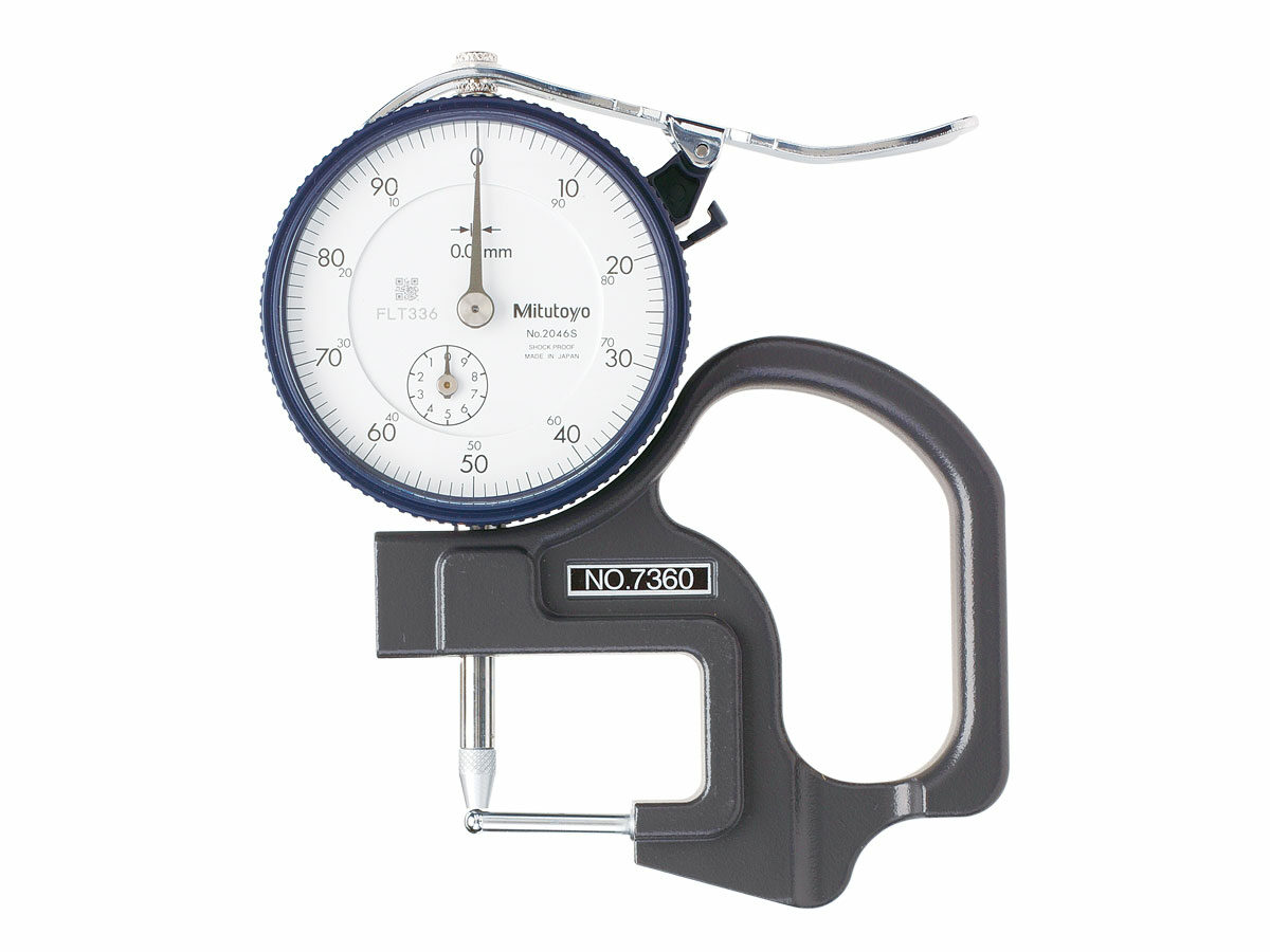

Tube Thickness Gage with a dial that is ready to take thickness measurements
Tube Thickness Measurement Gages
The Mitutoyo dial tube thickness gage features a curved contact point to provide highly accurate thickness measurements of tube and pipe walls as well as other curved surfaces up to 10mm/.5” thick.
The Mitutoyo dial tube thickness gage conveniently measures the thickness of curved pieces used in a wide range of applications. The tube thickness anvil reduces the surface area of the contact point for more precise point measurements and is coated in ceramic for durability and corrosion resistance. The grip handle, easy-to-reach lifting lever and spring-loaded spindle allows for faster, easier measurements without sacrificing accuracy.
  • Measures curved thicknesses up to 10mm / .5″ in thickness
  • White dial face for easier, precise measurement readings
  • Anvil and contact point are made of ceramic for better corrosion resistance
  • Measuring force is 1.4N or less
SERIES 7 Technical Data
Technology: Mechanical
Measuring Force: 1.4 or lessN
Remarks: Tube thickness
Required Accessories: -
Order No.: Product Image: Units: Range: Graduation: Accuracy:
7360A - Metric 0-10mm 0.01mm ±15µm
7361A - Inch 0-0.5" 0.001" ±0.001"
