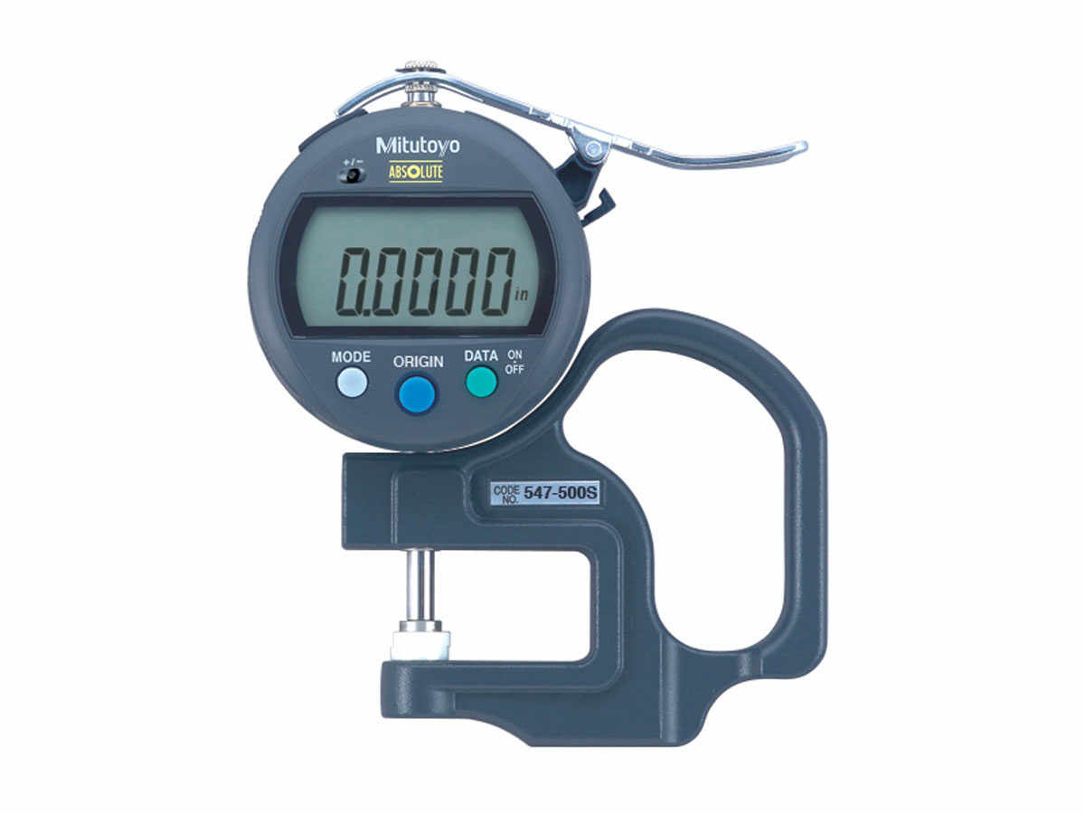

A Flat Anvil Thickness Gage made by Mitutoyo taking an accurate measurement.

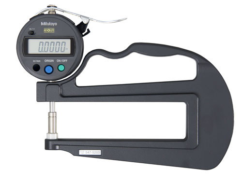

The Mitutoyo flat anvil digital gage quickly measures the thickness of different materials or objects with high accuracy. Measurements are shown on an easy-to-read LCD display. These gages are available with a standard or deep-throated frame.
The Mitutoyo flat anvil ABSOLUTE thickness gage can measure the thickness of a wide range of materials and objects including paper, film, wire, sheet metal and other similar materials. These flat anvil thickness gages utilize the Mitutoyo ID-C and ID-S Digimatic indicators to provide error-free LCD readings. The grip handle, easy-to-reach lifting lever and spring-loaded spindle allows for quick and easy measurements without sacrificing accuracy.

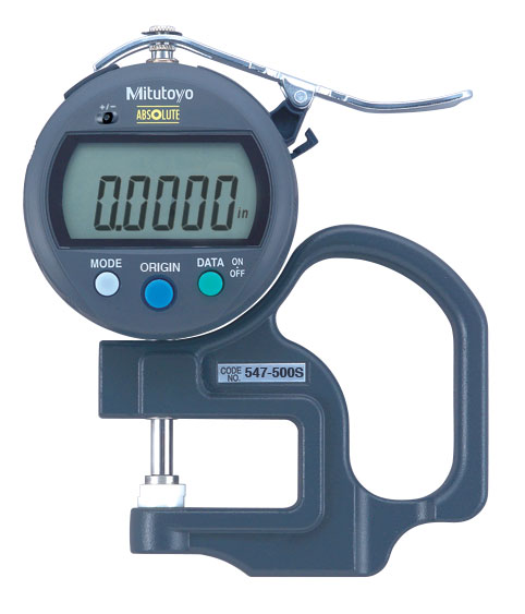

Order No.: Product Image: Range: Resolution: Accuracy: Indicator type: Measuring Force: Spindle material: Anvil material: Optional Accessories:
547-300S 0-0.4" / 0-10mm 0.0005" / 0.01mm ±0.001" Digimatic IDC 1.5 or lessN Ceramic Ceramic -
547-320S - 0-0.4" / 0-10mm 0.0005" / 0.01mm ±0.001" Digimatic IDC 1.5 or lessN Ceramic Ceramic -
547-400S 0-0.47" / 0-12mm 0.00005" / 0.001mm ±0.00015" Digimatic IDC 3.5 or lessN Carbide Carbide -
547-500S 0-0.47" / 0-12mm 0.0005" / 0.01mm ±0.001" Digimatic IDS 1.5 or lessN Ceramic Ceramic -
547-520S 0-0.47" / 0-12mm 0.0005" / 0.01mm ±0.001" Digimatic IDS 1.5 or lessN Ceramic Ceramic -
547-526S - 0-0.47" / 0-12mm 0.0001" / 0.001mm ±0.0002" Digimatic IDS 1.5 or lessN Ceramic Ceramic -
