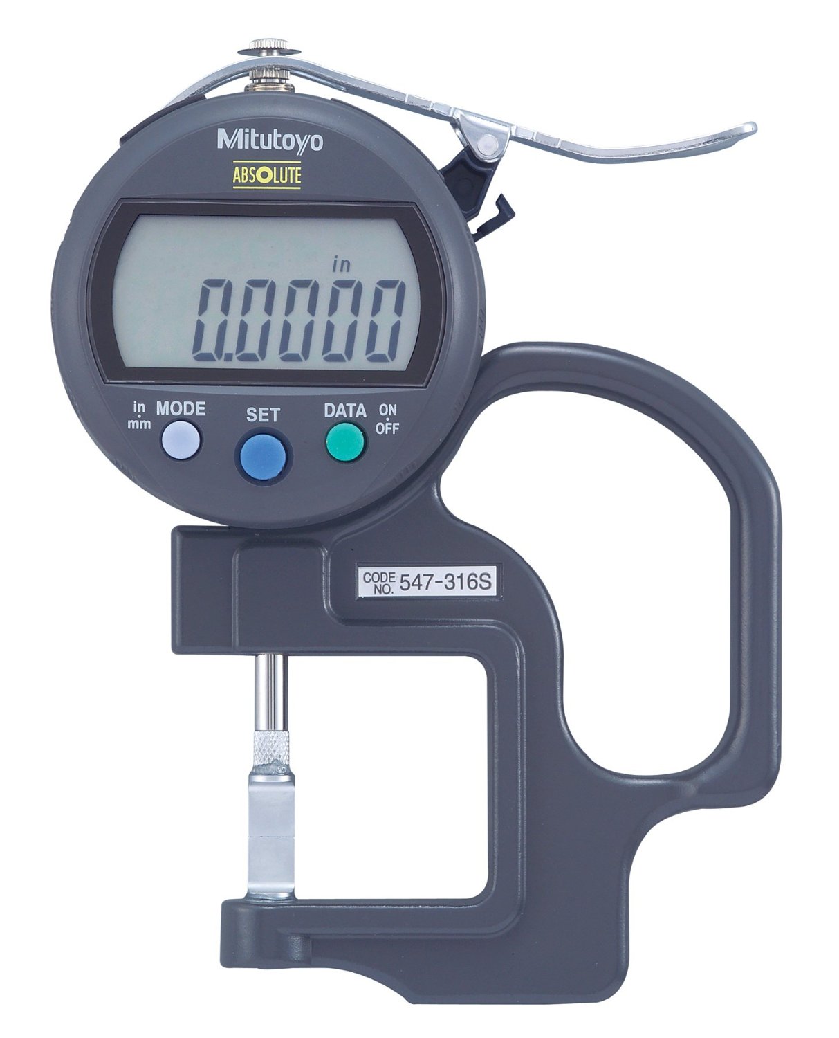

A Mitutoyo Groove Thickness Gage with Blade Anvils prepared to take Groove Thickness Measurements.
Groove Thickness Gages with Blade Anvil
The Mitutoyo digital groove thickness gage is designed with a blade anvil to measure the thickness of groove ranges up to 12mm/.47” with a ±.001” accuracy. Measurements are shown on an easy-to-read LCD display.
The Mitutoyo ABSOLUTE digital groove thickness gage can measure the thickness of grooves in a wide range of applications. The blade anvil is designed to reach into grooves to easily perform measurements that are otherwise extremely difficult to achieve with other indicators or instruments. These gages utilize the Mitutoyo ID-C and ID-S Digimatic indicators to provide error-free LCD readings. The grip handle, easy-to-reach lifting lever and spring-loaded spindle allows for quick and easy measurements without sacrificing accuracy.

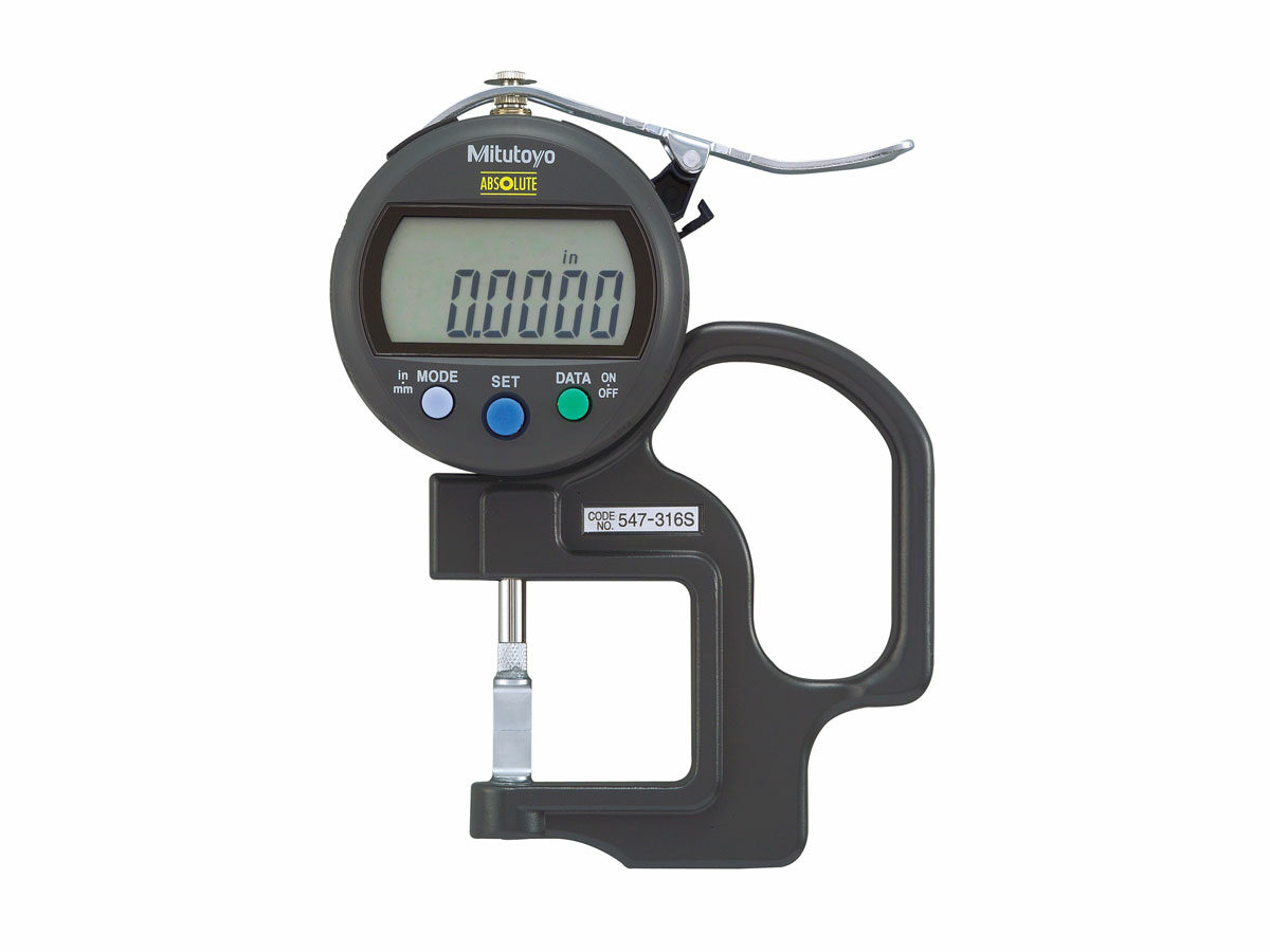

Order No.: Product Image: Range: Indicator type: Optional Accessories:
547-316S 0-0.47" / 0-10mm Digimatic IDC -
547-516S - 0-0.47" / 0-12mm Digimatic IDS -
