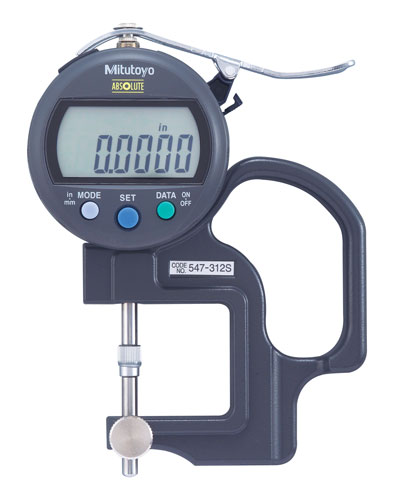

A Mitutoyo Lens Thickness Gage measuring the the thickness of wide range lenses.
Lens Thickness/Reverse Anvil Gages
Mitutoyo lens thickness measurement digital indicators quickly measure the thicknesses of a wide range of lenses up to 12mm/.47” with high accuracy.
The Mitutoyo lens thickness measurement digital indicator uses a reversible anvil to measure the thickness of various lenses with high accuracy. The indicators’ contact points are coated in ceramic for durability and corrosion resistance. The grip handle, easy-to-reach lifting lever and spring-loaded spindle allows for faster, easier measurements without sacrificing accuracy. ty, and the white dial face is easier to read.
  • Available in Inch/Metric models
  • Available with Digimatic ICS or IDC indicators
  • Easy to reach lifting anvil for effortless measurements
  • White dial face for easier, precise measurement readings
  • Anvil and contact point are made of ceramic for better corrosion resistance
  • Measuring force is 1.5N or less
Technology: Digimatic
Units: Inch, Metric
Resolution: 0.0005"
Accuracy: ±0.001"
SPC Output: Yes
Measuring Force: 1.5 or lessN
Reverse anvil: Yes
Battery: SR44 (1pc.) 938883
Battery life: Approx. 20,000 hours under normal use
Remarks: Lens thickness
Required Accessories: -
