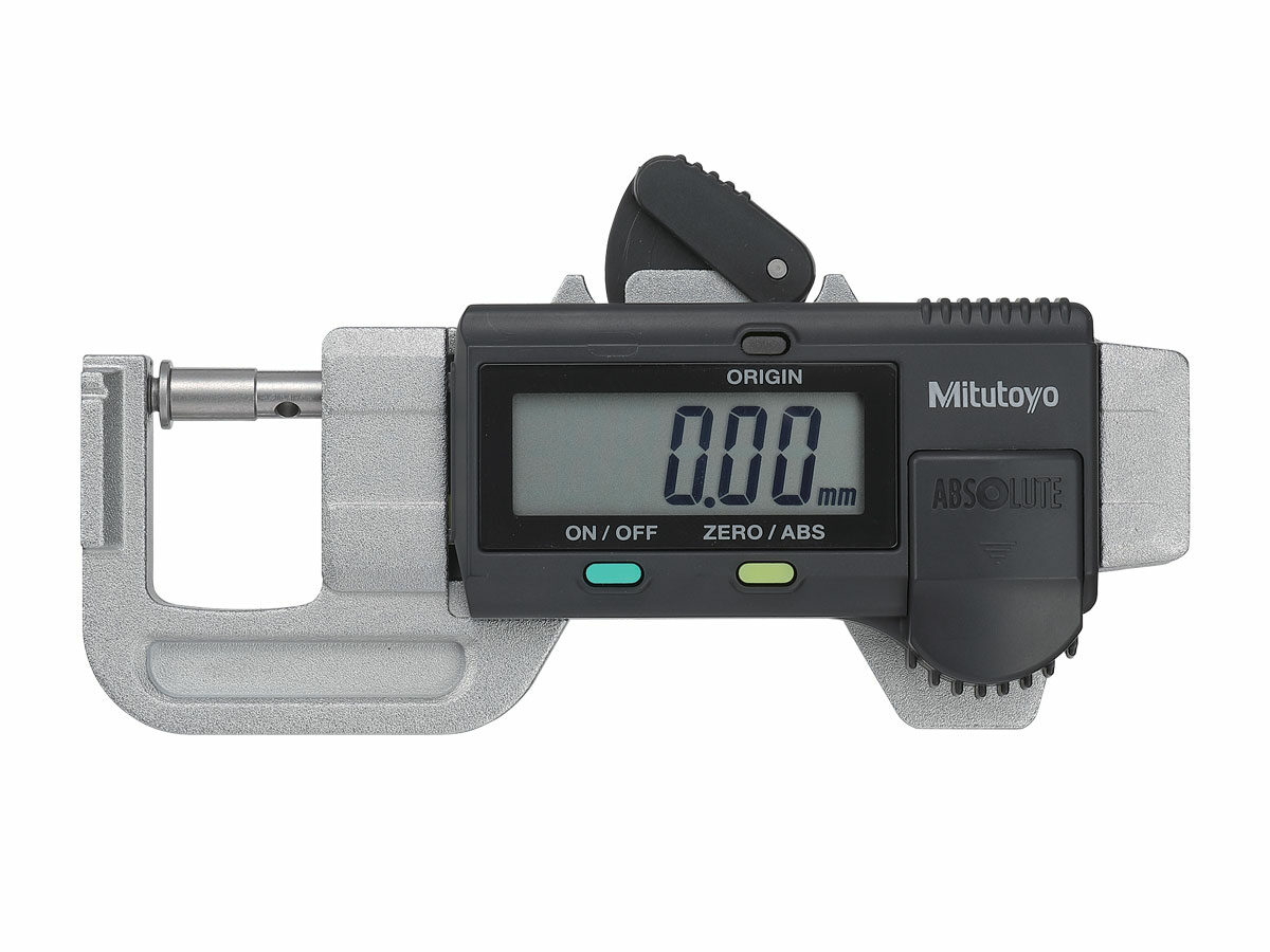

The Mitutoyo Quick Mini digital thickness gage is designed for fast inspection of small, thin or fine objects with a ±.001” accuracy. Measurements are shown on an easy-to-read LCD display.
Quick-Mini Thickness Gages
The Mitutoyo Quick Mini ABSOLUTE digital thickness gage is a compact, lightweight (70g) comparator designed for carrying convenience and portability. The Quick Mini is ideal for quick thickness inspections of paper, leather, wires, plastic parts and many other materials up to 12.7mm/.50” thick. The Quick Mini’s LCD provides error-free readings that are easy to read.
- Available in Metric and Metric/Inch models
- ABSOLUTE (ABS) linear scale eliminates the need for setting the origin point every time the gage is powered on
- Origin reset is not required even when data is re-displayed after disappearance due to insufficient illumination during use
- Functions include: Zero-setting, power ON/OFF, and inch/mm conversion (on inch/metric models only)
- Alarm: Low voltage, scale surface contamination and over-flow error
- Unlimited response speed eliminates over-speed errors
- Measuring force is 2N or less
