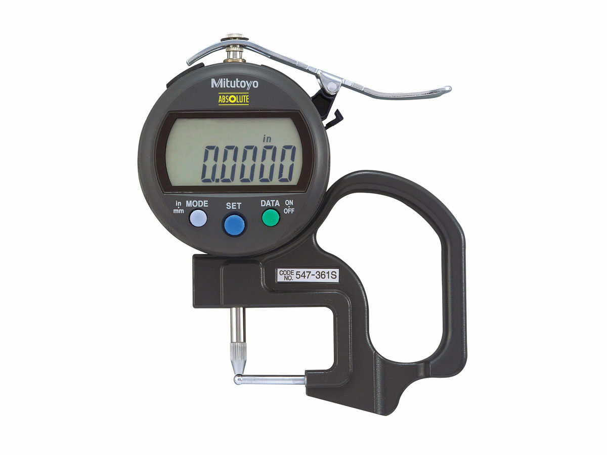

The Mitutoyo Tube Thickness Measurement Gage is zeroed and ready to take measurements for tube thickness.
Tube Thickness Measurement Gages
The Mitutoyo ABSOLUTE tube thickness gage features a curved contact point which provides highly accurate thickness measurements of tube and pipe walls. Measurements are shown on an easy-to-read LCD display.
The Mitutoyo ABSOLUTE tube thickness gage conveniently measures the wall thickness of curved pieces for a wide range of applications using materials up to 12mm/.47” thick. The tube thickness anvil reduces the surface area of the contact points for more precise point measurements of a piece’s rounded surface. These indicators utilize the Mitutoyo ID-C and ID-S Digimatic indicators to provide error-free LCD readings. The grip handle, easy-to-reach lifting lever and spring-loaded spindle allows for quick and easy measurements without sacrificing accuracy.
