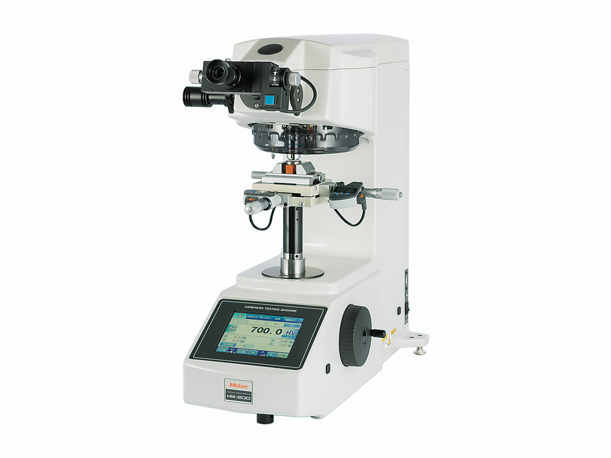

HM-210/220 Vickers Hardness Testing Machine – Type A
The Mitutoyo HM-210/220 Type A series Hardness Tester is ideal for quality control and mechanical characteristic evaluation using Vickers hardness testing in small areas.
The Mitutoyo HM-210/220 Type A unit utilizes a test-force loading device to set the desired test force and latest optical system ideal for measuring dimensions of indentation images. Its color touch panel controller provides a full suite of basic functions necessary for hardness testing including converting the hardness value into various types of hardness scales.
  • Automatic turret mechanism can manually or automatically change the position of the indenter and objective lens
  • The electromagnetic force motor in the loading mechanism enables the test force to be freely selected over the wide range of 0.4903mN to 19610mN (0.05gf to 2 kgf)
  • Ability to freely set load dwell times delivers control over indentation size
  • The long working distance objectives enable a comfortable working distance between the objective and the specimen surface reducing the possibility of collision between the specimen and the objective during focusing operations
  • Newly-designed MH Plan objectives are optimized for measuring indentation images
  • The motorized turret allows for up to four objective lenses and two indenter assemblies to be mounted at the same time
  • V/K models utilize both Vickers and Knoop indenters
Technology: Electro Mechanical Force
Measuring Method: Optical- Type A-Manual Filar
Included Lenses: 10X, 50X
Eyepiece: Dual Line, 10x, 0.01µ min
Display: Color LCD Touch Screen
Resolution: 0.001mm
Loading Time: 0-999 sec
X - Y Stage: 100x100mm
Travel Range: -
Max Sample Height: 121-133mm
Max Sample Depth: 160mm
Required Accessories: -
Optional Accessories: 11AAC104 Objective lens assembly 2X, 11AAC104 Objective lens assembly 5 X, 11AAC106 Objective lens assembly 10 X, 11AAC107 Objective lens assembly 20 X, 11AAC108 Objective lens assembly 100 X, 11AAC109 Knoop indenter assembly (HM210 Series), 11AAC110 Knoop indenter assembly (HM220 Series), 11AAC129 Measuring microscope, 19BAA058 Vickers indenter (HM210 Series), 19BAA059 Vickers indenter (HM220 Series), 19BAA061 Knoop indenter (HM210 Series), 19BAA062 Knoop indenter (HM220 Series), 375-056 Stage micrometer (Glass), 810-013 Thin plate specimen holder, 810-014-1 Wire specimen holder, 810-015-1 Wire or ball specimen holder, 810-016 50mm vise, 810-017 100mm vise, 810-018 Rotary table, 810-019 Tilting specimen holder, 810-020 Universal specimen holder, 810-084 Rotatable universal specimen holder, 810-085 Adjustable thin plate specimen holder, 810-095 Rotatale specimen stage, 810-420 25x25mm metric only stage, 810-423 50x50mm metric only stage, 810-424 1"x1" in/mm stage, 810-427 2"x2" in/mm stage, 810-454A CCTV Camera Unit 8.4" LCD, 810-641 Vibration isolation table, 810-650-1 Resin mold specimen holder Ø25.4, 810-650-2 Resin mold specimen holder Ø30, 810-650-3 Resin mold specimen holder Ø31.75, 810-650-4 Resin mold specimen holder Ø38.1, 810-650-5 Resin mold specimen holder Ø40, 810-870A Sample heating device (HST250)
Optical Path: 4-port objectives switching system of infinity-correction optical system
Mass: 43kg
Power Supply: 39VA 100-125/220-240V AC, 50/60Hz
Dimensions: 316x671x595mm
Output: Serial interface (RS-232), Digimatic interface, USB 2.0
