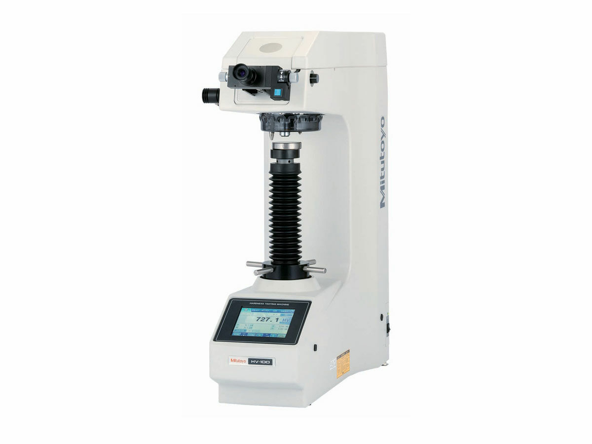

The Mitutoyo HV-110/HV-120 Type A series Vickers Hardness Tester operates as smoothly as electric models while maintaining the certainty of traditional test forces.
The Mitutoyo HV-110/HV-120 models performs multi-point and average hardness evaluations without the need for external data processors. The 5.7-inch color touchscreen display provides high visibility and allows the unit to operate easier.
- Feature motorized force selection from 1-50kgf or .3 to 30kgf
- A dual-line filar eyepiece combined with a color touch-screen LCD to create accurate measurements with the touch of a button
- The motorized turret can accommodate up to 3 long working distance objective lenses for an even wider range of materials and a wide variety of anvils and x-y stages are also available
- Digital output streams measurement data into software or spreadsheets
- LED illumination provides better visibility of specimen without producing heat
