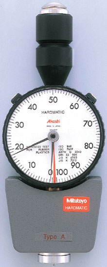

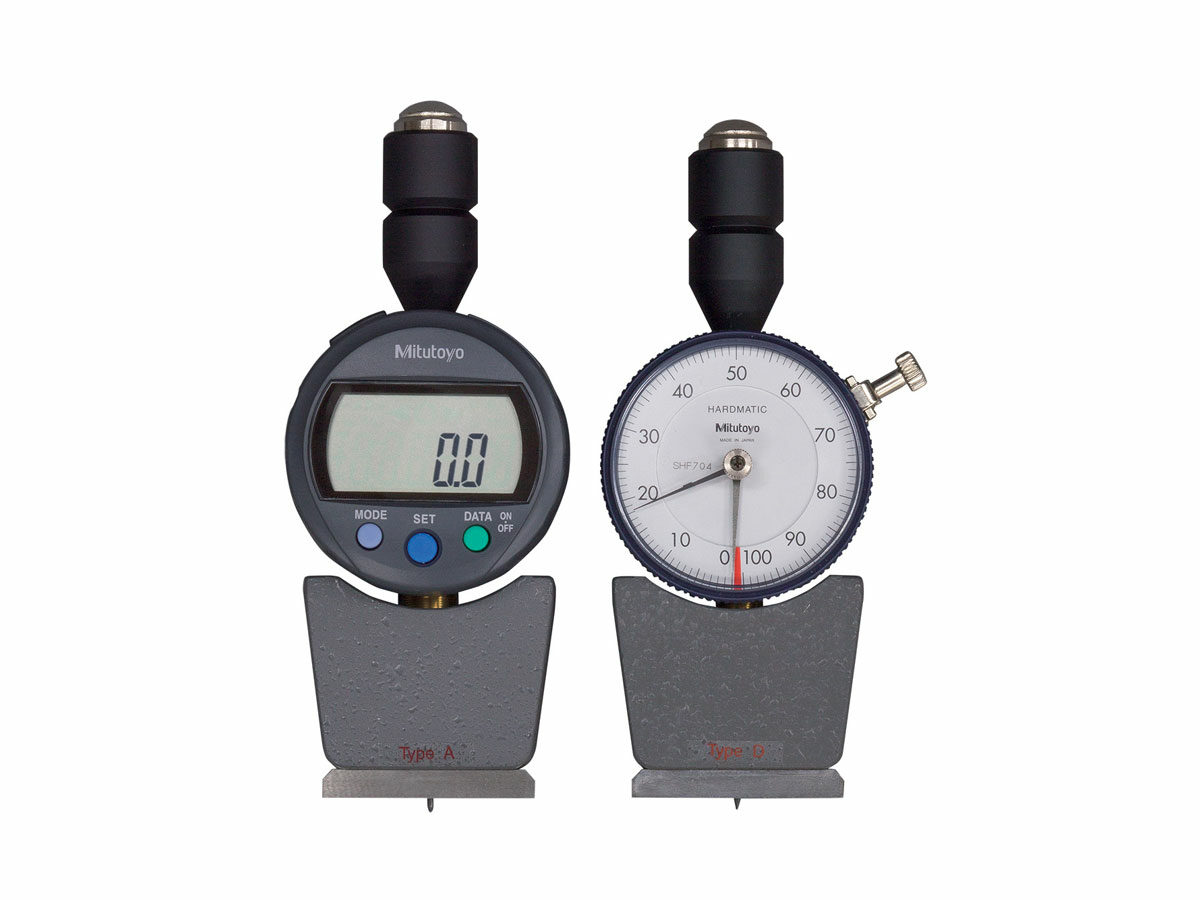

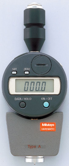

The Mitutoyo HH-330 Hardmatic Durometer is suitable for testing rubber, polyesters, PVC, leather, wax, vinyl, cellulose acetates, glass polystyrene and a variety of other materials.
The Mitutoyo Hardmatic digital and analog Durometer provides accurate, repeatable hardness test results on various soft materials from rubber and neoprene to leather and plastics. A data hold function (digital models) and peak retaining hand (on analog models) allows for error-free reading.
  • Units are available in both Shore A and Shore D scales and will test a wide variety of applications
  • LCD screen on digital models provides easy-to-read results
  • Data output function transfers measurements to PC or a printer (via optional RS-232 interface)
  • Designed in accordance with the ASTM D 2240, ISO868, ISO 7619, DIN 53 505, JIS K 6253, and JIS K 7215 specifications
Indenter Protrusion: 2.5mm
Order No.: Product Image: Model: Display: Shore Scale: Applications: Resolution: Range: Standard: Pressure Foot: Spring Force: Indenter Tip Type: Indenter Tip Diameter: Indenter Diameter: Tip Angle: Type: Dimensions: Mass: Digital Functions:
811-329-10 - HH-329 Dial E Soft Rubber, Sponge, Felt, Hard Foam 1 10-90 JIS K 6253 44 x 18mm WE=550+HEmN Sphere 0.79mm 5mm - Compact 56 x 33.5 x 144mm 300g Peak Retaining Hand
811-330-10 - HH-330 Digital E Soft Rubber, Sponge, Felt, Hard Foam 0.1 10-90 JIS K 6253 44 x 18mm WE=550+HEmN Sphere 0.79mm 5mm - Compact 60 x 28.5 x 151mm 290g Data Hold, Zero Setting, SPC Output, Power On-Off, SR44 Battery
811-331-10 - HH-331 Dial A Natural Rubber, Soft Elastomers, etc. 1 10-90 JIS K 6253, ASTM 2240, ISO 868, ISO 7619, JIS K 7215, DIN 53 505 Ø18mm WA=550+75HDmN Blunt Taper 0.79mm 1.25mm 35°±0.25° Long-Leg 56 x 33.5 x 186mm 320g Peak Retaining Hand
811-332-10 - HH-332 Digital A Natural Rubber, Soft Elastomers, etc. 0.1 10-90 JIS K 6253, ASTM 2240, ISO 868, ISO 7619, JIS K 7215, DIN 53 505 Ø18mm WA=550+75HDmN Blunt Taper 0.79mm 1.25mm 35°±0.25° Long-Leg 60 x 28.5 x 193mm 310g Data Hold, Zero Setting, SPC Output, Power On-Off, SR44 Battery
811-333-10 HH-333 Dial D Hard Elastomers, Plastics, Hard Rubber, Ebonite, etc. 1 20-90 JIS K 6253, ASTM 2240, ISO 868, ISO 7619, JIS K 7215, DIN 53 505 Ø18mm WD=444.5HDmN Sharp Point 0.1±0.01mm 1.25mm 30°±0.5° Long-Leg 56 x 33.5 x 186mm 320g Peak Retaining Hand
811-334-10 HH-334 Digital D Hard Elastomers, Plastics, Hard Rubber, Ebonite, etc. 0.1 20-90 JIS K 6253, ASTM 2240, ISO 868, ISO 7619, JIS K 7215, DIN 53 505 Ø18mm WD=444.5HDmN Sharp Point 0.1±0.01mm 1.25mm 30°±0.5° Long-Leg 60 x 28.5 x 193mm 310g Data Hold, Zero Setting, SPC Output, Power On-Off, SR44 Battery
811-335-10 - HH-335 Dial A Natural Rubber, Soft Elastomers, etc. 1 10-90 JIS K 6253, ASTM 2240, ISO 868, ISO 7619, JIS K 7215 44 x 18mm WA=550+75HDmN Blunt Taper 0.79mm 1.25mm 35°±0.25° Compact 56 x 33.5 x 144mm 300g Peak Retaining Hand
811-335-11 HH-335 Dial A Natural Rubber, Soft Elastomers, etc. 1 10-90 JIS K 6253, ASTM 2240, ISO 868, ISO 7619, JIS K 7215, DIN 53 505 Ø18mm WA=550+75HDmN Blunt Taper 0.79mm 1.25mm 35°±0.25° Compact 56 x 33.5 x 144mm 300g Peak Retaining Hand
811-336-10 - HH-336 Digital A Natural Rubber, Soft Elastomers, etc. 0.1 10-90 JIS K 6253, ASTM 2240, ISO 868, ISO 7619, JIS K 7215 44 x 18mm WA=550+75HDmN Blunt Taper 0.79mm 1.25mm 35°±0.25° Compact 60 x 28.5 x 151mm 290g Data Hold, Zero Setting, SPC Output, Power On-Off, SR44 Battery
811-336-11 HH-336 Digital A Natural Rubber, Soft Elastomers, etc. 0.1 10-90 JIS K 6253, ASTM 2240, ISO 868, ISO 7619, JIS K 7215, DIN 53 505 Ø18mm WA=550+75HDmN Blunt Taper 0.79mm 1.25mm 35°±0.25° Compact 60 x 28.5 x 151mm 290g Data Hold, Zero Setting, SPC Output, Power On-Off, SR44 Battery
811-337-10 - HH-337 Dial D Hard Elastomers, Plastics, Hard Rubber, Ebonite, etc. 1 20-90 JIS K 6253, ASTM 2240, ISO 868, ISO 7619, JIS K 7215 44 x 18mm WD=444.5HDmN Sharp Point 0.1±0.01mm 1.25mm 30°±0.5° Compact 56 x 33.5 x 144mm 300g Peak Retaining Hand
811-337-11 - HH-337 Dial D Hard Elastomers, Plastics, Hard Rubber, Ebonite, etc. 1 20-90 JIS K 6253, ASTM 2240, ISO 868, ISO 7619, JIS K 7215, DIN 53 505 Ø18mm WD=444.5HDmN Sharp Point 0.1±0.01mm 1.25mm 30°±0.5° Compact 56 x 33.5 x 144mm 300g Peak Retaining Hand
811-338-10 - HH-338 Digital D Hard Elastomers, Plastics, Hard Rubber, Ebonite, etc. 0.1 20-90 JIS K 6253, ASTM 2240, ISO 868, ISO 7619, JIS K 7215 44 x 18mm WD=444.5HDmN Sharp Point 0.1±0.01mm 1.25mm 30°±0.5° Compact 60 x 28.5 x 151mm 290g Data Hold, Zero Setting, SPC Output, Power On-Off, SR44 Battery
811-338-11 - HH-338 Digital D Hard Elastomers, Plastics, Hard Rubber, Ebonite, etc. 0.1 20-90 JIS K 6253, ASTM 2240, ISO 868, ISO 7619, JIS K 7215, DIN 53 505 Ø18mm WD=444.5HDmN Sharp Point 0.1±0.01mm 1.25mm 30°±0.5° Compact 60 x 28.5 x 151mm 290g Data Hold, Zero Setting, SPC Output, Power On-Off, SR44 Battery
