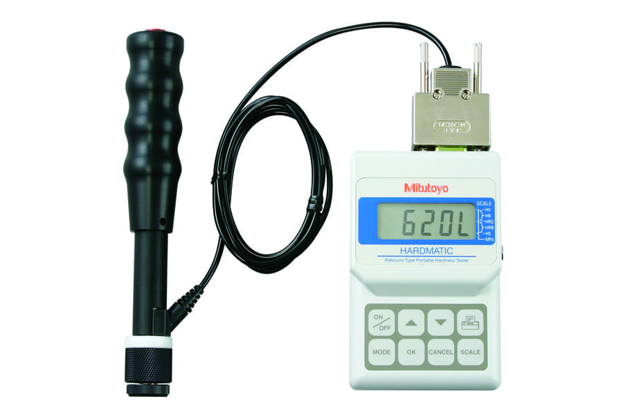

The Mitutoyo HH-411 is a user friendly rebound-type portable hardness tester for metal with a compact body and high operability.
The Mitutoyo HH-411 Hardness Tester features a selectable unit of hardness, automatically converting HL hardness scale results to Vickers, Brinell, Rockwell C, Rockwell B, Shore and tensile strength as required during testing. This function, along with generous storage capabilities and easy portability makes the HH-411 ideal for testing in the field.
- Single button touch performs non-destructive impact hardness test for easy on-site workpiece testing
- Data storage function stores a maximum of 1800 data entries for performing routine tests at work sites
- Auto angle compensation automatically recognizes impactor orientation and compensates so maximum accuracy is achieved in every measurement
- ASTM standard Including the display unit, D type impactor (810-287-10) and carbide ball (19BAA457)
| Order No.: | Product Image: | Model: | Hardness Range: | Detector: | Display Hardness: | Display Range: | Display Resolution: | Functions Conversions: | Functions Judgment: | Functions Offsetting Memory: | Indentation Direction: | Output: | Power Supply: | Detector Dimensions: | Display Unit Dimensions: | Required Accessories: | Accessories: | Detector Mass: | Display Mass: |
| 810-298-10 | - | HH-411 | L-Value (ASTM A956) | Input Device D (Carbide Ball) | HL, HV, HB, HRC, HRB, HS, HTN | 1-99 HL / 43-950 HV / 20-894 HB / 19.3-68.2 HRC / 13.5-101.7 HRB / 13.2-99.3 HS / 499-1996 Mpa | 1 HL / 1 / 1 HB / 0.1 HRC / 0.1 HRB / 0.1 HS / 1 Mpa | HL, HV, HB, HRC, HRB, HS, HTN | Go/no go | 1,800 data | Any | RS-232C, SPC | 2x Lithium AA Batteries | 1.10x6.89" / 28x175mm | 2.76x4.33x1.38" / 70x110x35mm | - | 120g / 0.26lbs | 200g / 0.44lbs |
