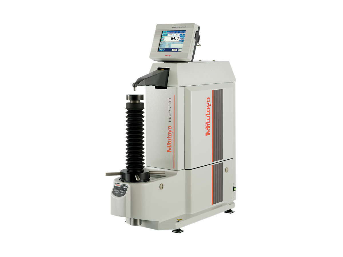

The Mitutoyo HR-530 series of Rockwell and Brinell Hardness Testers include a unique electronic control capable of Rockwell, Rockwell Superficial, Rockwell testing of plastics (A & B) and Light Force Brinell hardness testing.
HR-530/530L
The Mitutoyo HR-530 series of Hardness Testers include a unique electronic control capable of Rockwell, Rockwell Superficial, Rockwell testing of plastics (A & B) and Light Force Brinell hardness testing.
The closed loop test force control on the Mitutoyo HR-530 Rockwell and Brinell Hardness Tester allows for a wide variety of hardness testing including plastics. The HR-530 is capable of testing the inside wall hardness of rings without cutting the ring into pieces. An easy to use brake-start system automatically begins testing when initial force is reached.
  • The curved surface correction function enables curved surfaces, such as round bars and spheres, to be tested for hardness as easily as flat surfaces
  • Color touch screen control panel displays statistics and graphs; up to five display formats show needed information
  • Nose-type indenter enables measurement of a specimen’s flat top surface as well as inside surface of cylindrical specimen
  • The HR-530 is available in 9.8” (250mm) or 15.5” (395mm) height capacity models
  • Complete with a combination diamond indenter, a 1/16” carbide ball indenter, one flat and one V anvil, 2 HRC, 1 HRBW, 1 HR30TW and 1 HR30N test block
  • Hardness testing of plastics according to ASTM D785 (Procedure A and B) and ISO2039-2 are also possible
