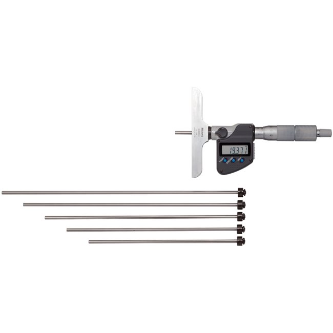

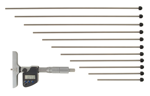

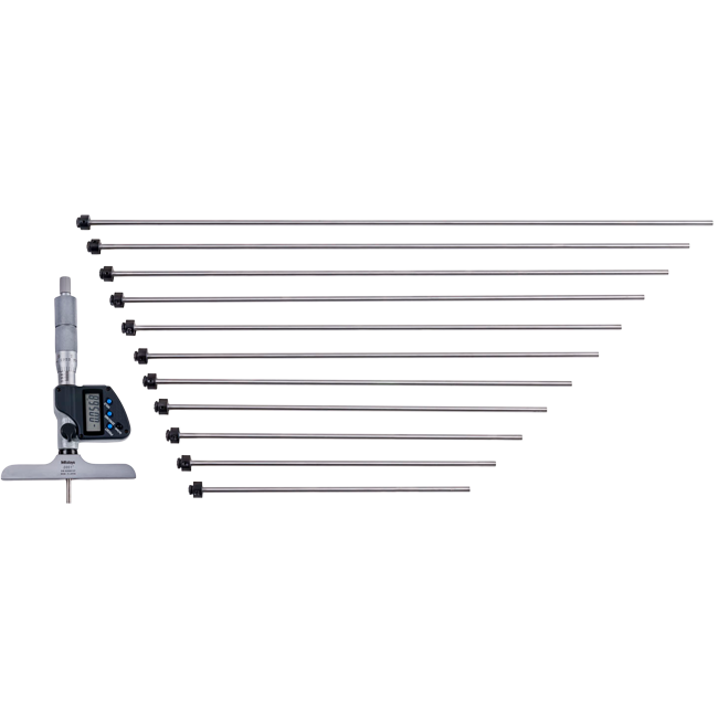

The Mitutoyo digital interchangeable rod type depth micrometer offers great versatility for measuring a range of depths with the included extension rods.
Digimatic Depth Micrometer with Interchangeable Rod Type
The Mitutoyo Digimatic depth micrometer with interchangeable rods measures a wide range of depths with high accuracy. Measurements are displayed on a digital LCD readout with SPC output for easy automatic recording.
The Mitutoyo digital interchangeable rod type depth micrometer offers great versatility for measuring a range of depths with the included extension rods. The depth micrometer’s rod contact measuring points are lapped and carbide tipped for incredible flatness and better precision. The ratchet stop mechanism provides uniform pressure for precise, repeatable measurements.
  • Available in two different ranges: 0-150mm/0-6” and 0-300mm/0-12”
  • Smaller range models include 6 interchangeable rods
  • Larger range models include 12 interchangeable rods
  • Rod length can be adjusted in 25mm/1” increments
  • Rod diameters are 4mm
  • Measuring rod clamps provide added measurement stability
  • SPC output function with optional water-resistant SPC cable allows for quick and easy data management in real time
  • Functions include Origin Set, Zero Setting, Data Hold, Data Output, Function Lock, 2 Presets and inch/mm conversion (on inch/metric models only)
  • Supplied with a fitted plastic case
