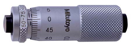

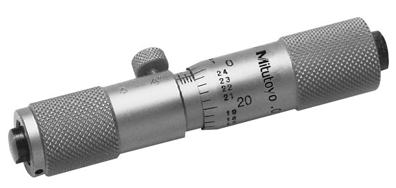

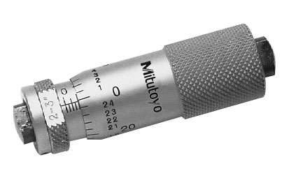

The Mitutoyo mechanical single rod type tubular inside micrometer takes precise inside dimension measurements of cylinders, rings and parallel surfaces.
The Mitutoyo single rod tubular inside micrometer features carbide-tipped measuring surfaces, a precision-calibrated screw and hardened steel spindle to take highly accurate, high resolution inside dimension measurements. A laser-etched scale on the coated glare-resistant micrometer head, and a convenient locking clamp to hold dimensions in place, helps make reading measurements easier. The zero set on these tubular micrometers easily adjusts with the included key wrench.
- Optional setting rings for zero point adjustment are available
- Ideal for fast, accurate inside measurements of cylinders, rings and parallel surfaces
- Adjustable zero-setting helps provide accuracy
- Carbide measuring surfaces provide better accuracy and wear resistance
- Scale on thimble and sleeve is laser etched for easier reading in all conditions

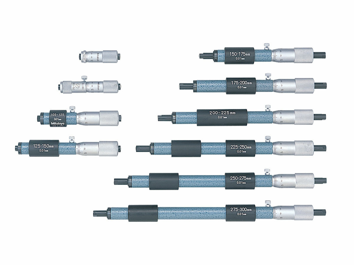

- Tubular inside micrometers up to 200mm / 8″ diameter measurements supplied in a fitted plastic case
- Tubular inside micrometers over 200mm / 8″ diameter measurements supplied in a wooden case

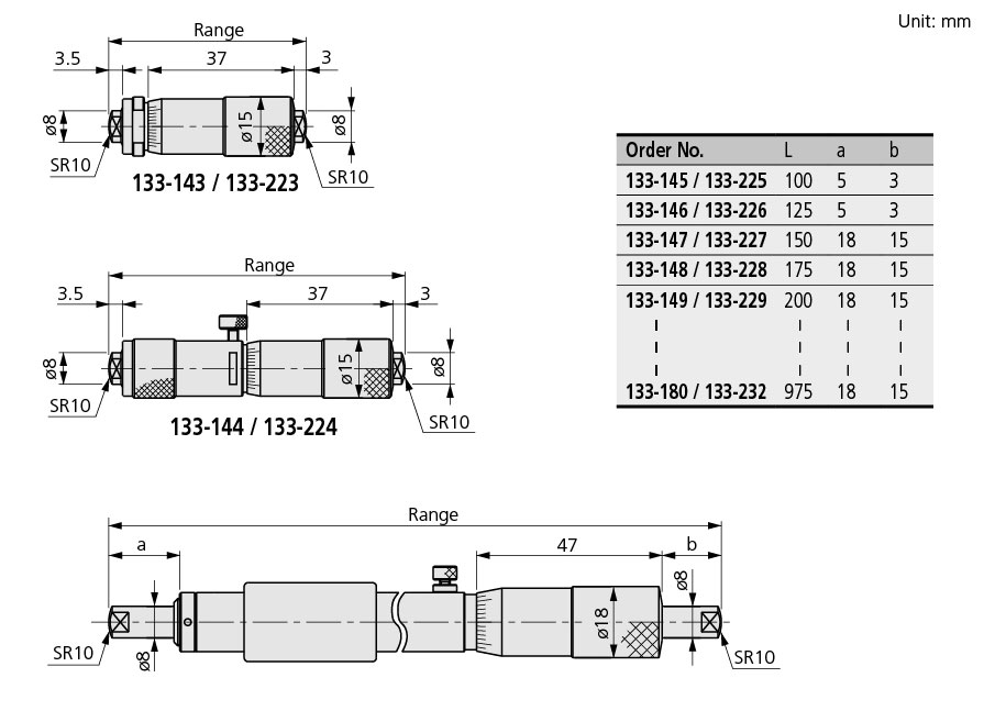

SERIES 133 Technical Data
| Technology: | Mechanical |
| Measuring Faces: | Carbide tipped |
