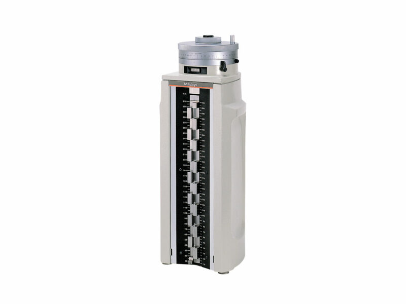

Manual height master features a speed dial type micrometer head with fine adjustment graduated to 0.00001” for height setting

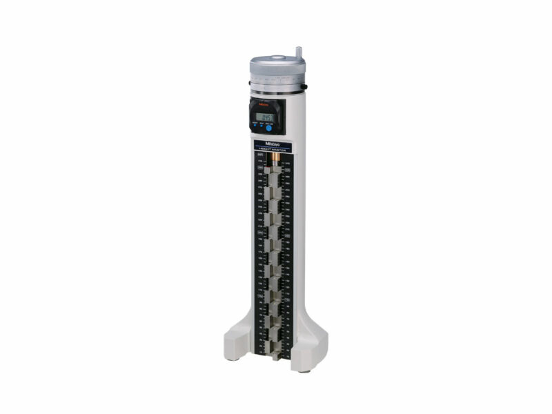

Digital height master with SPC output features a digital micrometer head with fine adjustment capabilities for height setting

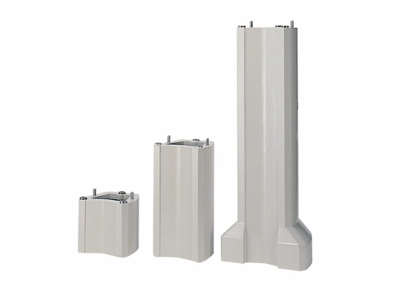

Riser blocks are available in three different height extensions and extend the height calibration ranges of Mitutoyo height master units

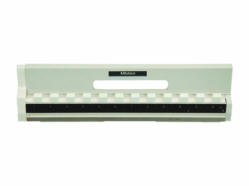

High accuracy check master checks machine tool table movement accuracy and calibrates CMM’s with permanently wrung gage blocks

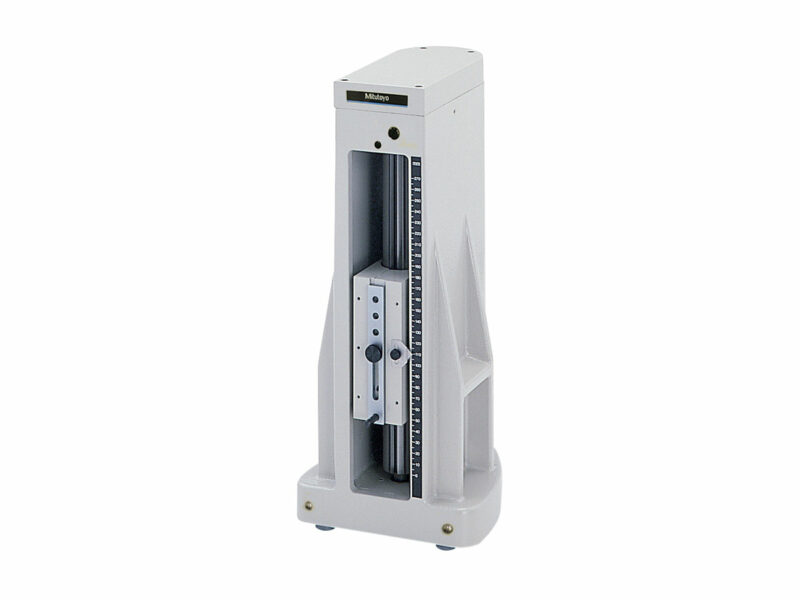

Squareness and straightness measuring instrument accurately performs squareness (perpendicularity) and straightness measurements
