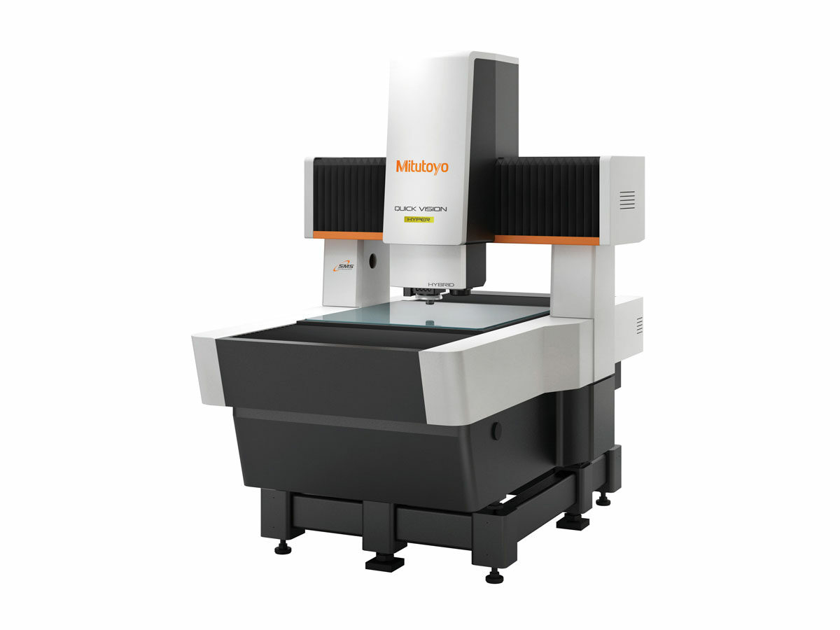

The Quick Vision Hyper Hybrid Pro Type 4 vision measuring machine uses a dual scanning system with a non-contact displacement sensor and scanning function that enables measurement of minute height differences and 3D shapes at high speeds.
The Mitutoyo Quick Vision Hyper Hybrid Type 4 features a dual measuring system that uses a high-resolution camera and non-contact displacement sensor to scan and measure minute steps and curved surfaces at high speeds. The proprietary Mitutoyo double-pinhole technique is used for the displacement sensor’s detection method. Compared to the knife-edge and triangulation techniques, this method has the advantage of a more optimal chromatic point sensor angle.
- Strobesnap reduces measurement times for most measurement samples regardless of measurement position continuity by approximately 35 to 45%
- Strobesnap is highly compatible with part programs, allowing you to create high-speed measurement part programs with simple operations
- The optional Stream function realizes amazingly high throughput by non-stop measurement that synchronizes the main unit drive with the strobe lighting
- Optional Tracking Auto Focus (TAF) quickly focuses on an object, improving throughput significantly
- Temperature compensation for higher accuracy
- Non-contact displacement sensor (CPS probe) uses the wavelength conofocal method
- Auto-brightness control and the use of LEDs as a light source allows the chromatic point sensor to perform measurements that are minimally affected by reflectivity variations on the workpiece
- The heights of two surfaces within the measuring range can be detected simultaneously making it possible to support measurements of the thickness of thin, transparent objects
