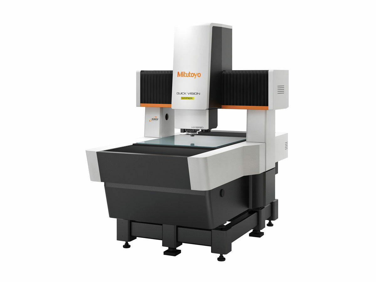

The Mitutoyo Quick Vision Hyper Pro CNC vision measuring system is equipped with a high-resolution/high-accuracy scale for precise 3D measurements with an increased measurement throughput by about 40% compared with conventional models.
The Mitutoyo Quick Vision Hyper Pro CNC vision measuring system attains highly-efficient, top measurement in performing 3D measurements. An updated camera, observation unit and lighting unit along with newly developed StrobeSnap function provides much faster measurements than previous models. The system accurately measures pitch, diameter, width and angle while performing surface analysis, cross-sectional dimensions, steps and contour matching measurements.
- Strobesnap reduces measurement times for most measurement samples regardless of measurement position continuity by approximately 35 to 45%
- Strobesnap is highly compatible with part programs, allowing you to create high-speed measurement part programs with simple operations
- The optional Stream function realizes amazingly high throughput by non-stop measurement that synchronizes the main unit drive with the strobe lighting
- Programmable Power Turret (PPT) uses three tube lens selection to provide three magnification levels with the same objective lens allowing a wide range of magnifications to support a variety of measurements
- A Programmable Ring Light (PRL) allows for obliquity fine control and direction for optimal measurement illumination to enhance the edge of inclined surfaces and very small steps
- Main frame structure has a fixed-bridge and a translation stage for independent X- and Y-axis movements to achieve high-accuracy
- Pneumatic auto-leveling vibration isolator is provided as a standard structure for added stability of measurement
- Standard temperature compensation offers higher accuracy in measurements
- Tracking Auto Focus (TAF) tracks the contours of waves and warpage on the surface of the workpiece while maintaining high-speed stream mode
